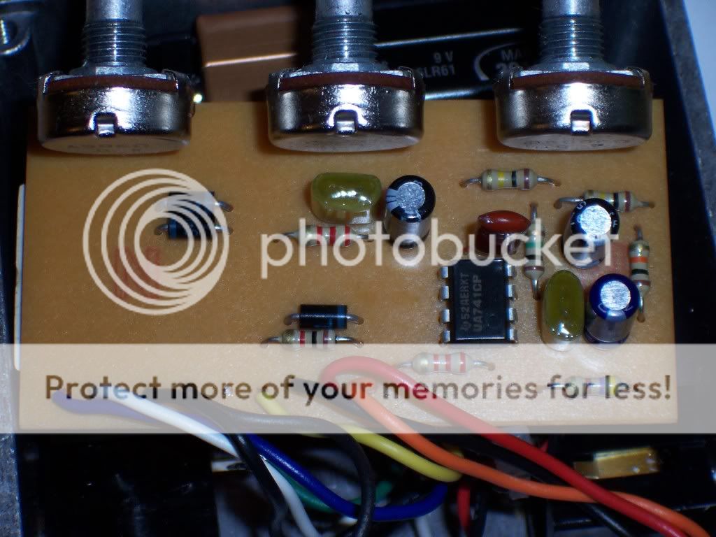

Hey guys, check pics of Boot-Leg Jazz Fuzz guts. Here's some info from japanese site

here you go, maybe when i've more time i'll draw a schem

ok... i was so much in this thing that i've draw a first schem... the first part untill the 2k2 after the opamp is ok to me, but the volume and vintage pots section is looking really strange :scratch: :scratch: :scratch:
have I done something wrong???

well i took a look at the pics on the japanese website and now i corrected the pads.
well, i agree that it's not possibile that the signal is grounded like this... i checked again the pcb and now it look like this:
but i still have those crazy groundings (marked in red) ....

i know this particular bypass switching is a bit strange. but is what i could tell by looking at the pictures found on effector-repair.com!
it would be fine if picassochild could send us some more pics of the wiring between swtich, pcb and jacks or at least check out if the schem is right

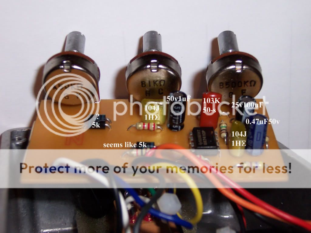

Using the photos ^^^ and Gila's schem, I though I better finally contribute to this forum.
... there may be something blindingly obvious that I missed, please critique. :D

now the last point is to know what diodes are those, an idea is 1N400x, but also some schottky diodes look like this

CJ, it certainly seems to be correct (possibly with the exception of the bypass switching - I just drove 700 miles and can't even see straight :shock: ) ... but hey, you know my old eyes :lol:
I did double-check my layout (a few times, so 6 checks??) last night, and I'm convinced that is true to the PCB shown on the Japanese site.
From the photos on the Japanese site, I managed to untangle their switching too ... can't edit my initial post, so here it is in its entirety.

Edit: ... just looked again after some caffeine, and yes, the schem is good to go. 8)
And 'scaling' aside ...this might be a useful add-on if anyone needs it.
