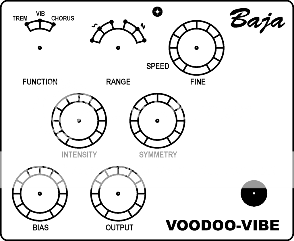

Hi folks
Here is the graphic I used for my build in an NSC1790 case (smallbear or pedal parts plus)
If you want the hi res artwork just PM me
Baja Voodoo Vibe front panel label
jt
