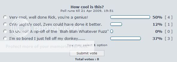

I'm messing about with the Big Muff circuit on my breadboard right now. This is something that came out of it that I thought was really cool sounding. It's the second stage of a Big Muff with a couple of component values changed and a pot added to control the diode clipping. It goes from slightly dirty boost through to nice gritty clipping. I've tried it with BC208, BC107, BC238 and BC547, sounds nice (nasty) with all of them. Si diodes are good, Ge create too much volume drop really. Clipping reduces volume by it's very nature, so the more clipping is dialled in the less volume, so increasing the clipping requires you to increase the output volume (Boost pot) to maintain the signal level. The Clip pot reduces the amount of signal reaching the diodes, so with the pot at maximum resistance the diode have very little to clip, so the signal is 'almost' clean. The circuit can provide simultaneous clipping and boost with both pots maxed out.
I'll wait for someone to pipe in and tell me that all I've done is re-invent the "Blah Blah Whatever Fuzz", in the meantime I'm having a little dirty fun with it.
frequencycentral wrote:I'll wait for someone to pipe in and tell me that all I've done is re-invent the "Blah Blah Whatever Fuzz", in the meantime I'm having a little dirty fun with it.
Hmmm..... At least the "Crunch"-control in the Way Huge Swollen Pickle MkII does exactly the same (with a 470kA potentiometer).
BTW, 47k at the base of the transistor reduces the overall gain a bit much.

analogguru wrote:BTW, 47k at the base of the transistor reduces the overall gain a bit much.
I'll remove it altogether and see what happens, thanks guru!

It's worth playing about with the value of the 47K resistor in this circuit. Removing it completely gives loads more gain, but you lose the clean boost facility. Maybe I'll try lowering the value (the BM is 33K) or making it switchable. It does look quite like the though Muffer doesn't it?
