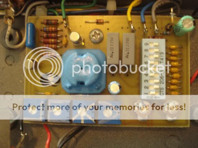

"fresh" guts from an early RMC-3:
http://i2.ebayimg.com/01/i/000/b5/69/0e9d_3.JPG
http://i16.ebayimg.com/07/i/000/b5/68/eeff_3.JPG
http://i2.ebayimg.com/01/i/000/b5/69/0026_3.JPG
Description from the seller:
Very early Teese RMC3 Wah in excellent condition. I learned from Mr. Teese that this was one of his earliest RMC3's. Before he went into full production with his own cases, Mr. Teese stuffed Crybaby and Vox shells with his circuit until these companies hit him with a cease and desist order. This wah even predates his regular serial number production models. The wah comes with the original instruction sheet and the adjustment tool. I sent the wah to Mr. Teese's shop about a month ago to replace a bad pot and for a check up where it received a clean bill of health. I had a newer version of the RMC3 and this early one at one point. To my ear the early RMC3 sounded "richer" than the newer one. I sold the newer one and kept this one. I have'nt had the need for a wah lately and I need some funds so this one is up for grabs. I will probably regret selling it but I would rather see someone enjoy it as opposed to it sitting in my closet.

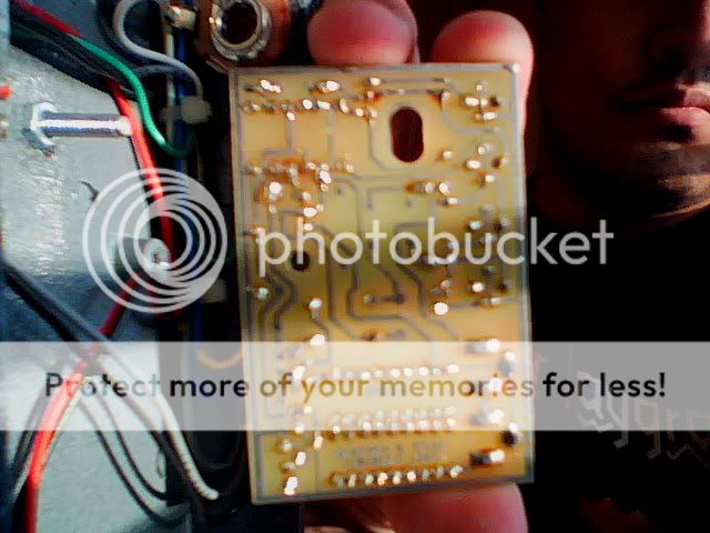

Here's the trace side of mine. The pic is from a crappy web cam but I guess it's better than nothing. Don't know if anyone is interested at this point though.
I've got a decent pic of the component side though.
