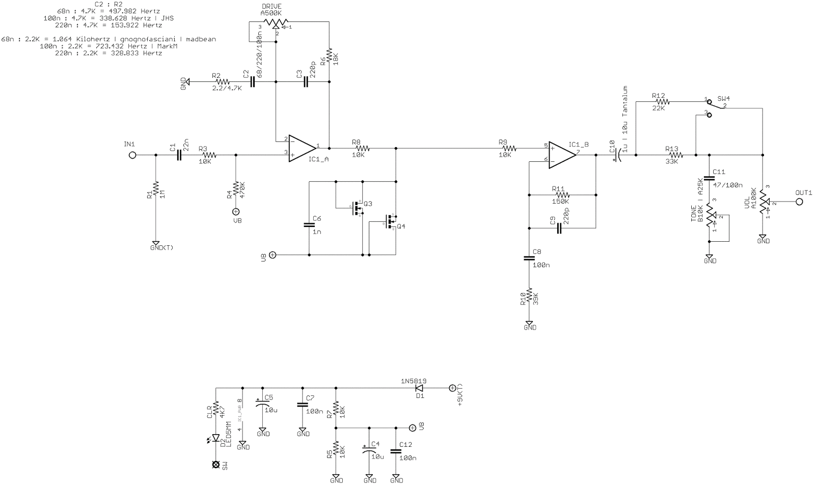

Just wanted to put some light on how exactly the clipping transistors and the germ. diode are connected.
I have a V4 here on my bench and I see that Source and Gate are connected together (trannies are 2n7000).
So we have S+G and D, where D corresponds to the striped end of a normal diode.
---->|---[S+G] [D]----
This represents how the germ diode and the 2n7000 are connected in series

Intripped wrote:Just wanted to put some light on how exactly the clipping transistors and the germ. diode are connected.
Thanks for posting some first hand evidence on the connections.
It still seems to be widely (and wrongly IMHO) accepted that the gate is connected to the drain (as in the schematic yongki posted above), even though people have hinted otherwise earlier in this thread.
So does your OCD have the same clipping configuration as the Joyo clone's corrected circuit I posted here - the "Circuit when D2 is in the "correct" orientation"?
You've got ---->|---[S+G] [D]---- and the corrected Joyo is electrically the same with ----[S+G] [D]---->|---
Or put another way, on the schematic yongki posted above, move the gate connections from the drains to the sources?

howmuch wrote: So does your OCD have the same clipping configuration as the Joyo clone's corrected circuit I posted here - the "Circuit when D2 is in the "correct" orientation"?
[ Image ]
YES to all
...and to avoid any further confusion, here is the exact clipping section:

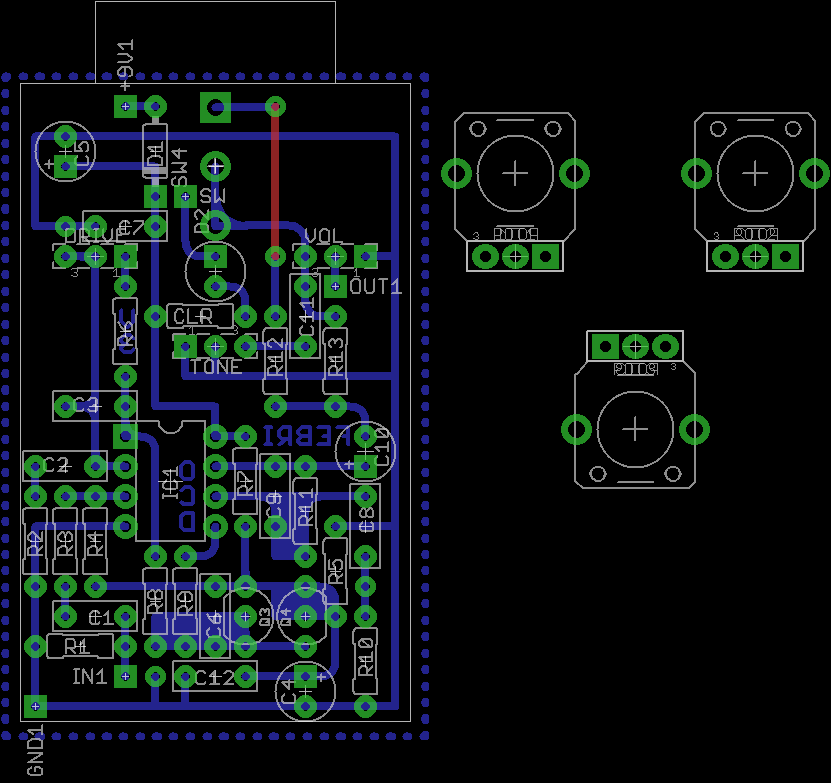

Hi guys!
Can you give me verified fulltone ocd pcb layout?
storyboardist
Posts: 104
Joined: 28 Dec 2013, 00:08
Location: Georgia, USA
Has thanked: 81 times
Been thanked: 224 times
Post by storyboardist »
Here's my layout.
287m

Post by 287m »
Nice layout David :thumbsup
perfect for 1590B
so i present to 1590A Club masochist :mrgreen:
