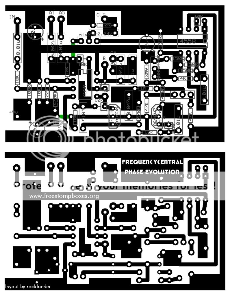

I've been working on a PCB layout for this.. about 2/3 done, but (as usual) tying up the loose ends toward the end of the schematic is getting tougher.. will hopefully have a V1 layout by the start of next week.. be good to get some feedback as to viability.
will make it as a daughter board situation for now, then introduce an all in one board with switching later on I think.

okay.. here's my first attempt at a layout on this.. looking forward to being told where I"ve screwed up heh.
I followed the vero layout rather than the schematic so am pretty confident I'll have buggered something up.
{}{not even close to verified}{}
