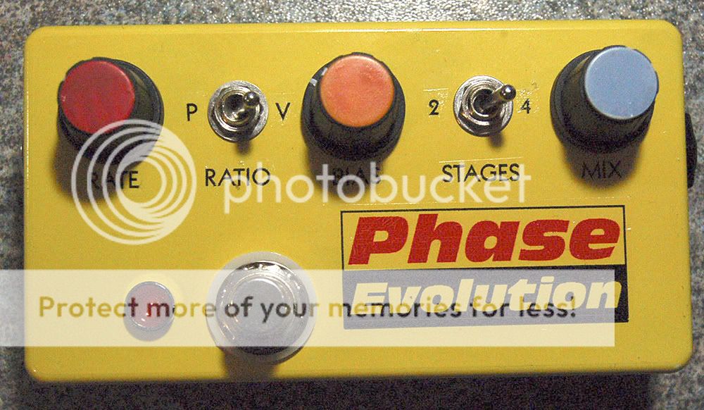

Small cap value error on my layout: C7 should be 0.1uf, not 0.01uf. I will amend and re-upload the Photobucket image, in the interests of perfection!

frequencycentral wrote:Small cap value error on my layout: C7 should be 0.1uf, not 0.01uf. I will amend and re-upload the Photobucket image, in the interests of perfection!
if that's the case, should C5 also be 0.1? just seeing if it's symmetrically following the other side of the switch.
frequencycentral
Posts: 696
Joined: 30 Mar 2009, 09:37
Location: United Kingdom
Has thanked: 28 times
Post by frequencycentral »
No, C5 is correct at 0.01uf. The whole thing with the Univibe caps ration option is for the caps to be of a 1:10 ratio as opposed to being symmetrical, hence 0.01uf and 0.1uf - see the schematic and JC's webpage. I've corrected the layouts now anyway.

I've just finished building this on perfboard (my first effort on perfboard) and I have to say, it's a lovely sounding phaser!
I used a 4PDT switch so that I could choose between 2 and 4 stages. It took a little while to work out I was doing something wrong. Originally I had linked points A-D and B-C on the switch for the 2-stage opetion before realising I should have a 10k resistor between B and C. Works like a charm now!
Getting it all in the box was, er, interesting, especially as I wanted the battery option, but it does all fit, just! That explains why my pedal is somewhat asymmetric......
I have a feeling that I'll have to build a few more for friends.
Mark.

frequencycentral wrote: 23 May 2009, 13:29 Here's the daughter board layout. C4 is mounted on the copper side of the board between pins 1 and 5 of the 4558. R4 and R5 (both 10K) are mounted under the 4558's socket:
Dear all, I'm sorry to resurrect this very old post, those days i'm trying to mix the thing up with a new build.
I'm actually trying to build an origianal MXR Phase 45 (without the JC Maillet mods, or at least only the vibe switch) + the 2-extra-stage mods.
From what I can see the 2-stage daughter board reported here have some "inconsistency" between the verolayout and the schematic.
Here follows my suggestions for the typos:
  • In the Verolayout of the daughter board, R2 is reported as 10R, but it's 10K (from the schematic)
  • In the text referring to daughterboard, the one quoted, the two resistors on the copperside are R2 and R3 and not R4,R5 which are visible :D
I'll give you more updates once i'll get my hands on all the component which i'm ordering.
