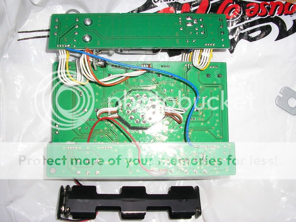

Hey I opend it up and actyally it is singlesided and doesn;t look really complicated, however i find it very difficult to track down.
Here are the pictures:

No, it's double-sided for sure. There are traces on both sides of the board.

Oh yeah like that, i see. At least there are components on one side!

dont forget the LED behind that tube! :mrgreen:

Oh yeah exaclty, it has one of those blue leds behind the tube, looks fancy.
So what would be the procedure to convert this into a schematic and a new pcb + layout?

Looks like there is a lot of silicon in there for a so-called tube device...
The tube must be here to warm up the sound a bit...

This pedal is actually 2 times VOX Big Ben Overdrive only with a bass boost.
I thought already that the tube isn't really doing any huge overdrives here. There is way too much gain in thi pedal to come from a tube.
