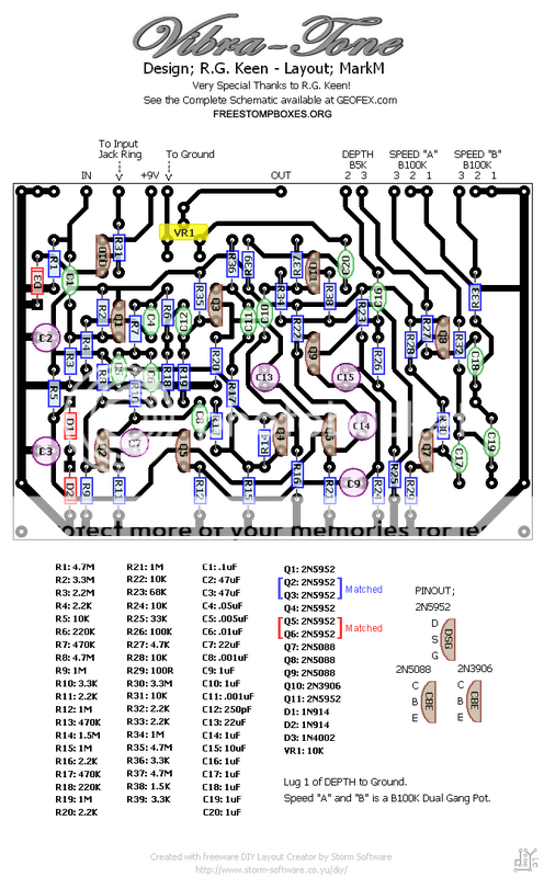

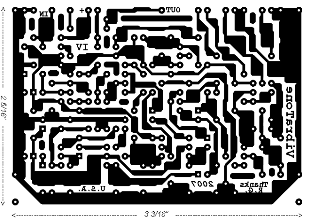

Well, here's a great sounding true Vibrato circuit.
This is the finalized version The volume drop issues that some
experienced with weaker FETS has been addressed and now a trimpot
is on the output to control the level of the engaged effect.
I thought I may as well post it in this section here as I have been Banned over at diystompboxes.
Have a look;
Layout;
https://i17.photobucket.com/albums/b72/ ... LAYOUT.png
Transfer;
https://i17.photobucket.com/albums/b72/ ... ANSFER.gif
Enjoy!
