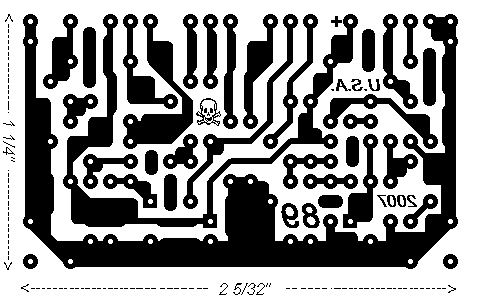

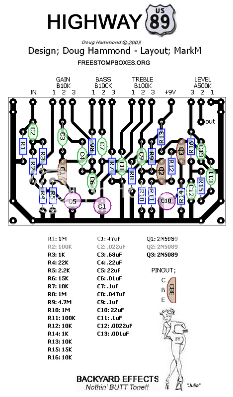

This is the Famous Highway 89 from Doug H.
A wonderful circuit that is quite popular!
Thanks Doug!! :D
https://i17.photobucket.com/albums/b72/ ... LAYOUT.png
https://i17.photobucket.com/albums/b72/ ... ANSFER.gif

Now you inspired me to give another show to the Highway 89. The one I built didn't worked correctly because of a bad pot (I used the pot in another effect and saw it wasn't working). I put the board in a box with all my "in progress" builds, now it's time to bring it back to life :twisted: . Also, please stop to post links and info about cool circuits, my list of "to build" effects is big already :P .
