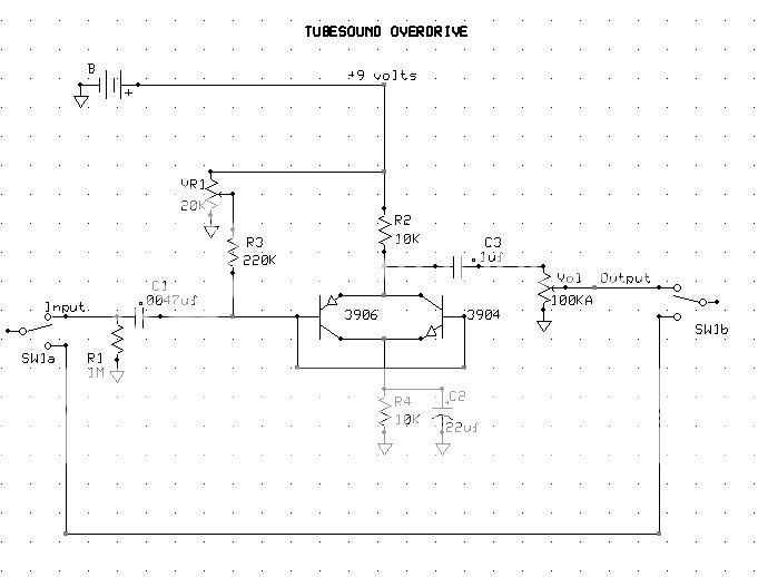

    Lately, I was tinkering with an unusual transistor circuit
    configuration I had come upon a few years ago and made a few
    modifications to the circuit that turned it into one beautiful
    screaming "tube-like" overdrive but without the wall of noise these
    things usually make. When pushed it even makes that distintive
    "zoo-zoo" sound...!!!
    The original circuit was simply a complementary matched pair of
    transistors connected so that all the terminals overlapped. i.e. both
    bases tied together, emitter of the PNP connected to the collector of
    the NPN, and the collector of the PNP connected to the emitter of the
    NPN. Thus:
    This transistor pair is then biased by 2 equal value resistors in each
    of the compound legs, one to the positive supply and the other to
    ground common. The signal is coupled to the base pair leg and the
    output is picked off either of the other 2 legs.
    The result is that the above circuit exhibits the behaviour of a
    multiplier over a range of signal values. It basically performs a
    sin function: in other words a frequency doubler.
    This doesn't have a very good distortion sound though because it is
    rather "burpy and buzzy". However, lately I was toying with the
    circuit when I offhandedly decided to try doing something to it just
    to see what would result.
    After adding a large cap from the NPN's emitter to ground the thing
    went wild on me... WANGO ZE TANGO! SUPREMO DISTORTION! I then
    proceeded to refine the circuit a little more and got a better
    understanding of what it was doing.
    The final schematic follows but first a couple of notes on the
    circuit. The "bias balance" trimmer should be adjusted for a
    symetrical clipping threshold of the output signal as viewed on a
    scope. Short of this it can be easily set by "ear" for the most
    sensitivity somewhere around mid-turn.
    The input should be driven by a lo-z stage if your electric guitar
    doesn't have a built-in pre-amp. You can alter the emitter capacitor
    value in a range from 0.1uF to 1uF in order to obtain various basement
    characteristics but I found the indicated value is a good compromise.
    The input capacitor should not vary much either though because if it
    is made too large the circuit goes balistic and cuts out on the tutti.
    "Tube-sound" Distortion Overdrive Circuit:
    The operation of the circuit more closely resembles a vacuum tube than
    a diode clipper does because of the strong square law characteristic.
    This is due to the negative feedback around both base-emitter pairs.
    This feedback accentuates the junction non-linear behaviour manyfold.
    Thus each transitor drives the other even harder so that the transfer
    curve ends up more logarithmic than is typical of a single transistor.
    In other words: the clipping is gradual and not abrupt like it is in
    the case of a silicon diode. Typically a lot more 2nd harmonic is
    produced as well. As a bonus the waveform folds over on itself when
    the circuit is overdriven!

Would this schematic work to build the Tubesound OD? I know it's a crude drawing.
OK, I just breadboarded this circuit and it's totally cool. Not what I expected at all. All I can say is man that's a '70's sound if I ever heard it. I thought the overdrive was fuzzy yet smooth. Once the trim was set it really sounded nice. So now I have to decide between the Harmonic Jerk or this. So, you guessed it I'll have to build both. I was thinking of using them both in the same box. The HP as a rhythm and the Tubesound for the lead sound. Just thinking out loud. :?

Yesterday i tried this little circuit on my breadboard. After some tweaking i got very nice overdrive sound. Cleans up very well and works great with guitar volume pot. Here's the schem i used:
schematic
and here's a sound sample:
sound sample - 650kB. PRS SE->OD->Pandora PX4D as speaker sim->Compact4->PC. Mixed in Reaper. Bass guitar is the same guitar but shifted down one octave with pandoras octaver. Musically poor, but i think that it shows the overdrive structure.
I think adding another one OD stage will make a screamin monster from this circuit. I'll defeinitely try it and post the results.
