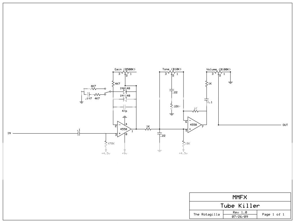

MMFX Tube Killer schematic.
Posted: 26 Jul 2009, 22:45
by The Rotagilla
This was more about me getting the hang of Express PCB's schematic software than an earth shaking revelation. There may be drawing errors but the values are correct.

That switchable 4k7 cannot go directly from pin2 to ground (through the switch allright). There must be a cap in between for DC decoupling.
Otherwise I do not see any resemblance to any known circuit on the market :mrgreen:

Dirk_Hendrik wrote:That switchable 4k7 cannot go directly from pin2 to ground (through the switch allright). There must be a cap in between for DC decoupling.
You're right, my mistake. :oops: It heads to a 0.1uf and the input cap should be a .047uf, I'll correct it soon.
