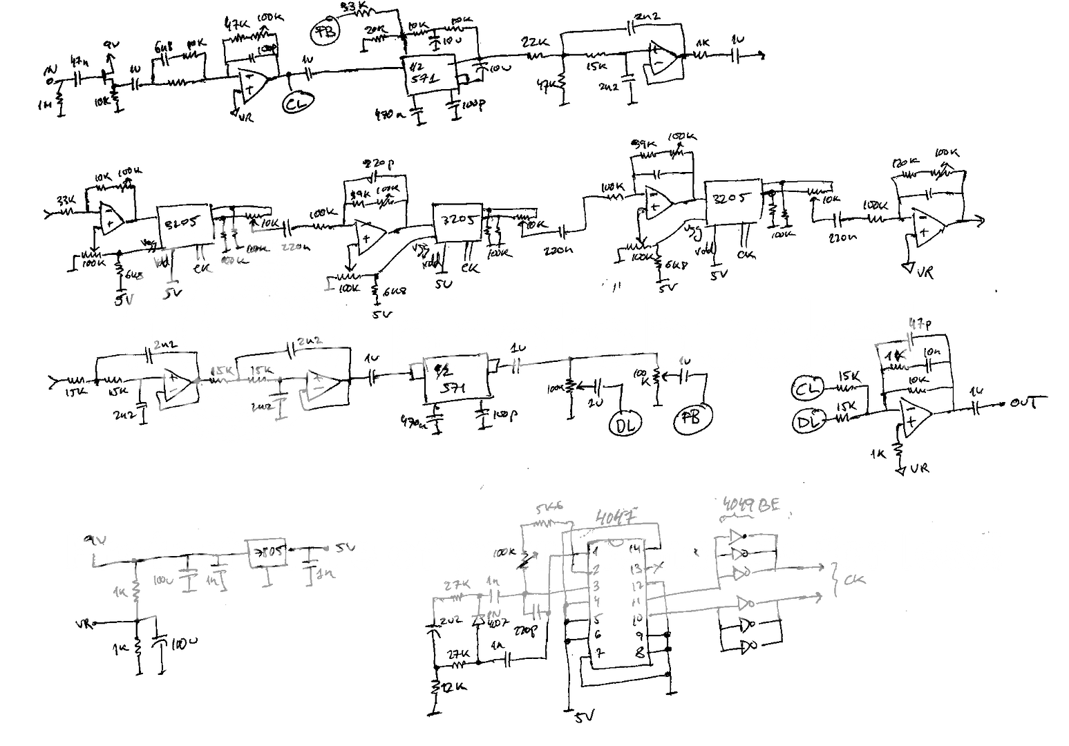

i got on the breadboard a stripped down DMM, using one 3205, 9v
the audio path goes preamp->compressor->prefilter->3205->postfilter->expandor
the key point here is the input voltage that suit 3205, much smaller that 3005. About 0.5vpp is a sensible amplitude to avoid clipping.
The pre-filter on DMM is amplifiying, so now for the 3205 must be at least gain 1. Also, post-filters are preceeded by a gain reduction on DMM, while here for 3205 must be at least some positive gain
The schematics for delays using 3205 usually shows the chip powered at 9v. I find at 9v there's a lot of background hiss. This gets much quieter if run off 5v. So both clok and delay circuits are now on 5v.
Filters look like they are too agressive, dark sounding, My fear is 3205 is inherently darker sounding than 3005, so getting relatively bright clean repeats will be tough. One more reason to benefit from a tracking filter. Also a faster clock and additional delay chips would help, since these are cheap.
right now i find aliasing a greater problem than clock filtering when going into long delay times. a sensible 150ms is a good compromise for one 3205 stage.

this is what i have now on the breadboard, 3x 3205, no modulation yet
its still a bit dark, need more work on the filters

i am thinking...
Each 3205 has a insertion loss dependant on input's frequency, thus creating a low pass filter on the way through the BBD chip. I guess this is where the main "analog" character of the repeats come from.
Instead of stacking chips in series, which will give longer delay times, but a stronger low pass as a trade-off...
what about paralleling chips, on a differential operation?
each chip gets its bit of phase inverted from the input, running at complementary clocks, and the outputs get combined in a differential amplifier.
Theoretically this allows for clock and harmonics cancellation, and Nyquist freq now equals clock rate. Then clock freq could be slowed to achieve same times like a two-in-series operation but only with 4096 stages which lessens the mentioned low-pass effect.
does it make sense?
anyone wants to try? my breadboards are busy at the moment...

i have tried the "differential" configuration.
Its a balanced split going into each 3205, and then combining the outputs into one opamp with differential inputs.
It sounds ok, the performance is not that good as expected theoretically, i guess because of all the mismatch on two separate ics and surrounding components.
Good thing is the whining noise can be cancelled easily, but the post-filters still need to be strong enough to avoid the aliasing
For the delay time of about 500ms i think prefer 3 3205 in series (1+1+1), with a higher clock rate and higher order filter, than 4 parallel (2+2).
I am putting this aside, until i get bigger breadboards, :roll:

isnt AP already one mn3005?
for a second 3005 i guess you can just take the output from the 10k balance trim, bias again and go into the 2nd delay ic. Just make sure you have about 100k impedance load on the MN outputs
I used one opamp stage like the DMM, to adjust gain and bias, and a potential filter.
the main difference i found in going DMM's 3005 to 3205 is that in the 3005 design, signal is boosted before the 3005 stages, and then attenuated after, while with 3205 is the opposite, due to the reduced input levels.
for the clock, all that mn3102 can be replaced with the DMM's 4047 stuff. Note the trick of using the bias trimpots to get Vgg for the MNs
