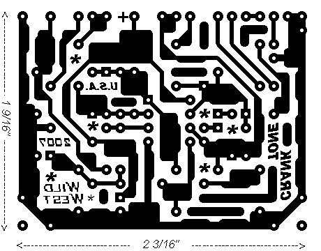

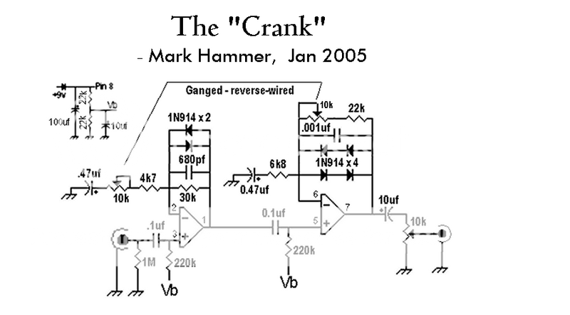

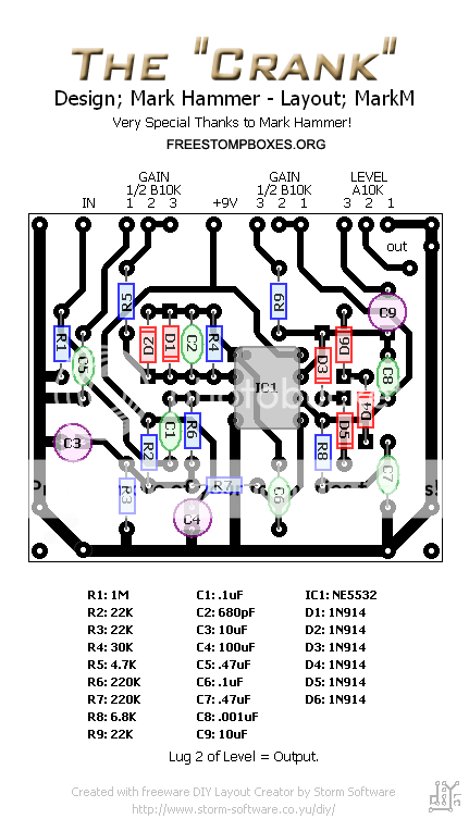

Isn't that Mark Hammer's take on making a low gain overdrive (Klon, Hotcake?)
Did you build that Mark? How is it?
I built one of these a while back - made everything sound flat and 2 dimensional if you get my drift - not one of my favourites :(
markm
Posts: 787
Joined: 26 Jun 2007, 14:41
Location: U.S.A.
Post by markm »
bajaman wrote:I built one of these a while back - made everything sound flat and 2 dimensional if you get my drift - not one of my favourites :(
+1
.......or would that be -1? :lol:
modman, I don't think it was supposed to be Klon-like which it isn't.
It was supposed to be a blendable light-OD, which it is but, after building it 2 times, + building the version with the TC and trying numerous different op-amps and clipping arrangements, I recycled the components!
