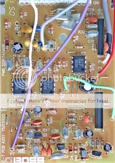

Just replace the ones marked TL022

I'm confused as to which op amps need to be replaced in the old 4 op amp version....sorry to be a pain but want to make sure I buy the correct parts!
Andy
roseblood11 wrote:The opamps are the most important part. Then you could replace all electrolytic caps in the audiosignal path with film caps (Panasonic SMF are small enough). If there are carbon resistors with higher values, replace them with metalfilm
and from a previous post:
by roseblood11 » 17 Jan 2009, 02:42
-replace the three JRC022D with RC4559P
(NE5532AP, OPA 2134, OPA2132 or OPA2604 should work as well and maybe even sound better, but the 4559 is a good and cheap choice here - it´s most important to replace the NJM2068 with a high quality, low noise chip, see below...)

Here is the guide I used. http://www.rhythmanddetonation.com/?p=79 with a nice big piccie of the PCB
Pretty sure the Vintage version has 3 TL022 which are crap and can be replaced with TL072 , 4559P , NE5532AP etc . Think I used 4559's IRC. The NE is supposed to be good but is quite High current
The 4558DD (the IC by itself) does not need changing

Replace everything that looks like "...022" or "4558" with 4859.
Is the a HA12017 or similar? I guess that it´s a standard dual opamp in a SIL package, but I´m not sure, if it has the same (standard) pinout as the mentioned NJM2068 opamp, so you have to compare datasheets to see how the DIP-SIL adapter for the OPA2134 has to be wired. (That´s the most important part, as it´s the first opamp in the signal chain...)

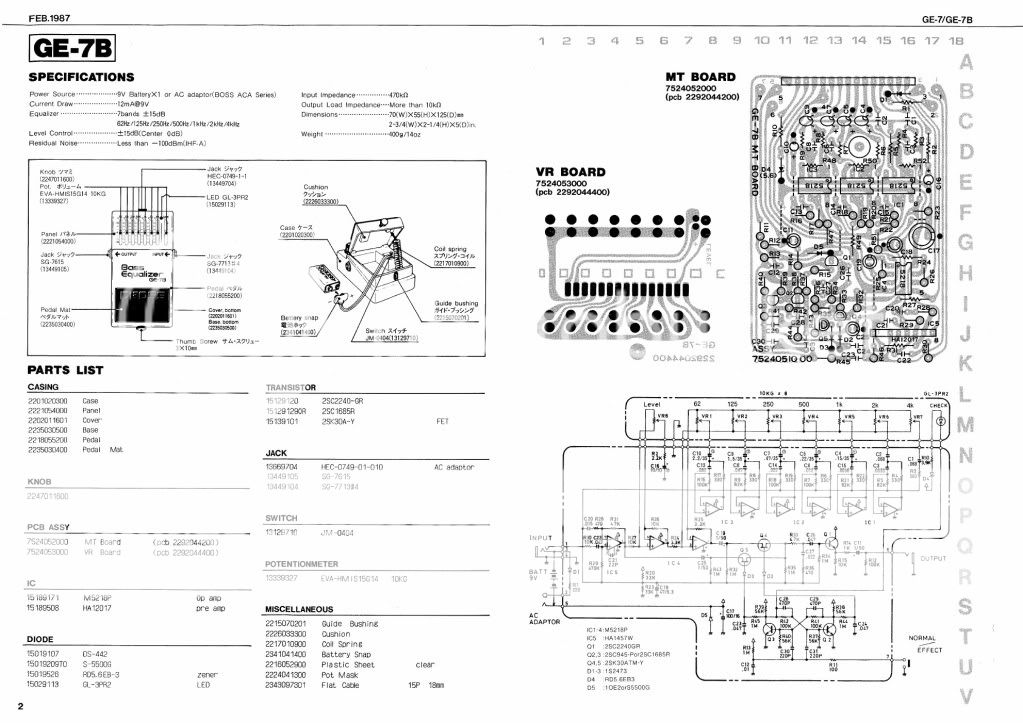

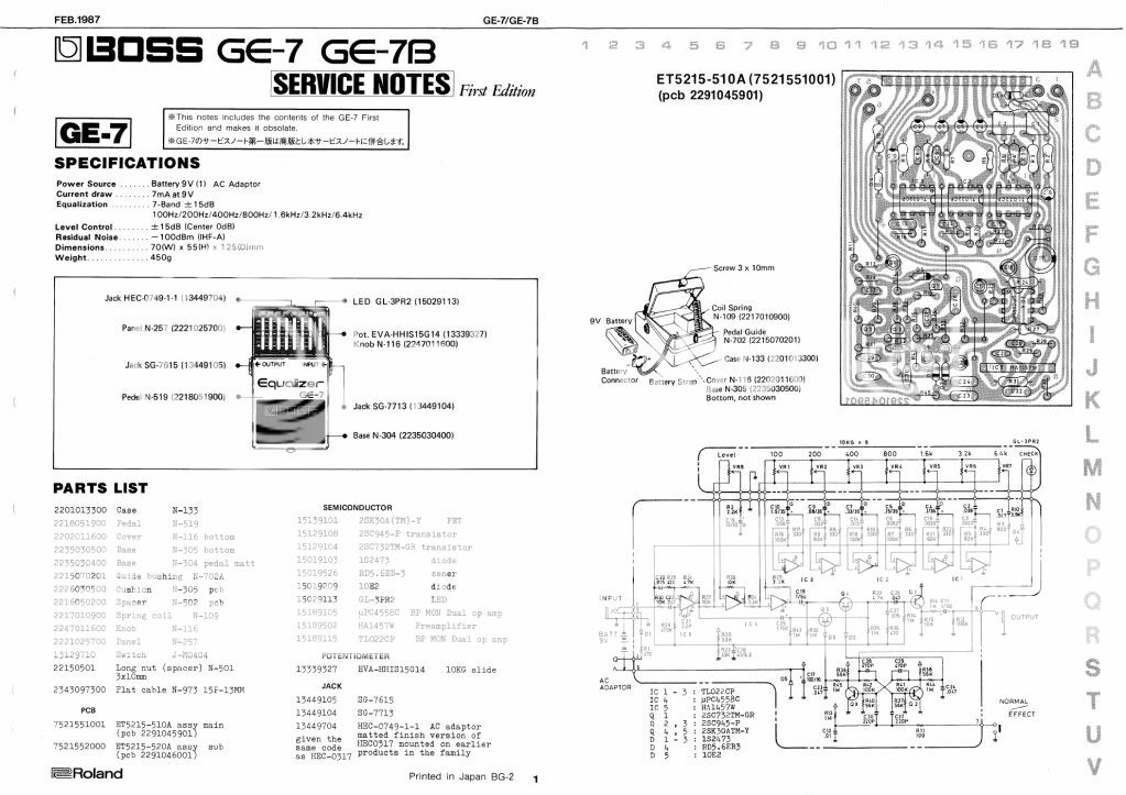

I just received this info from Roland Europe, the electronic schematic for GE7(1), GE7(2) and GE7B (bass).
GE7(1)
GE7(2)
GE7 Bass
Hope it could help anyone. :thumbsup
See ya !

But do you have larger files? The parts values are almost not readable. Esp the Ge-7 for guitar, second version, would be interesting

These are the original pdf files that I received from Roland Central Europe.
