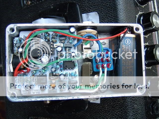

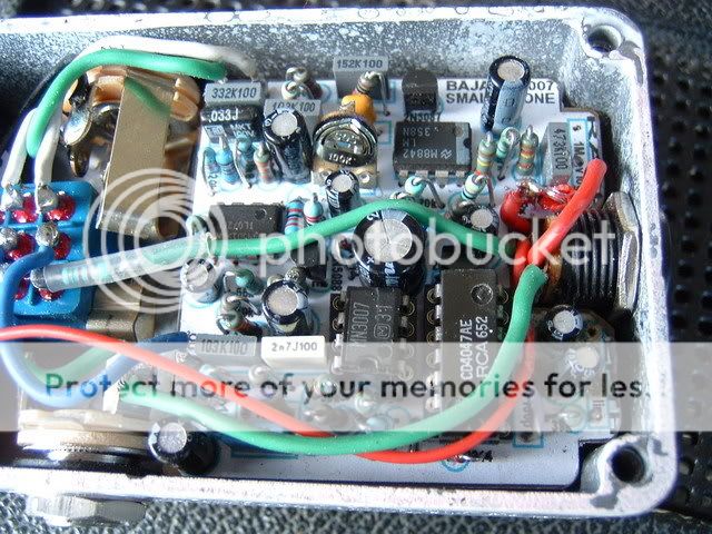

I have heard a lot of positive comments regarding the Electro Harmonix Small Clone, so I thought I would build one to evaluate it.
I found a layout and schematic etc., at Francisco Pena's Tonepad site, but I wanted to fit it into a Hammond 1590B case with a DC input socket and battery, and the Tonepad board was too long to fit, so I set to work reducing it's size.
I wanted to mount the potentiometers using 30 amp fuse wire to the rear (tracks) of the circuit board. I used stick on 3mm thick rubber bumpers on the rear of the alpha pots to avoid shorting against the solder tracks etc. I had to bend the extension wires to fit the pad layout - a bit tricky but worked surprisingly well.
I used a 1M linear pot - instead of the reverse logarithmic pot specified - no problems - and a 10k linear pot for the depth control, rather than the slide switch. I cut a notch to clear the DC socket which I mounted on the audience side of the case - like boss and ibanez etc.
I was pleasantly surprised when it worked first time, and it sounds really nice for a simple circuit - well worth the building effort in my opinion.
Anyway here is the board and layout if anyone wants to give it a go.
Have fun and enjoy

One helpful suggestion - cut the layout picture and glue it to the circuit board after you drill the holes, then use a sharp pointed tool and punch through the paper, and insert the correct components where marked - instant component layout - cheaper than a silkscreen
higher res artwork is available - just PM me

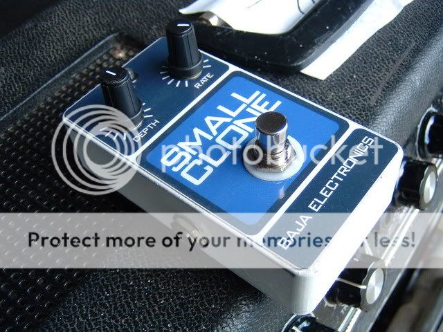

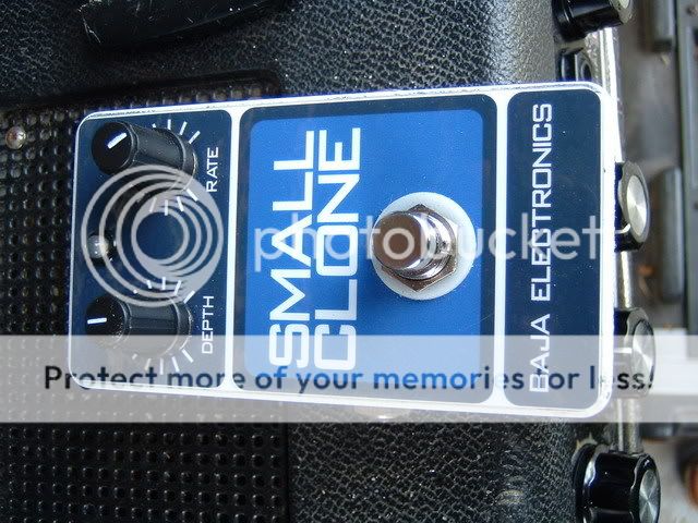

Baja, this is a beautiful build!
If you don't mind me asking, I would love to hear how you do the finish.
It looks like a painted 1590B box (which paint method?) and then a full faced label.
Is it a sticky paper label with clear coat on it?
I'm really a noob at the finish part, so I would love to get some pro tips
Thanks,
Mike.

Hi Mike A
I use Duplicolor white spray can lacquer paint - 3 thin coats, but for production models I get them white powdercoated, because it is a far more durable finish.
For the label - I print it on my printer using coated photo type inkjet paper (epson), then I laminate it with a cheap home A4 hot laminator.
Then I trim the label and attach it to the case with Nitto double sided adhesive tape. ( you could use a suitable tube glue if unable to find the Nitto)
A craft knife and round file are used for the switch, led, and potentiometer mounting holes.
