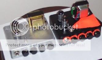

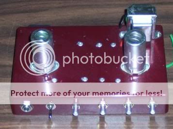

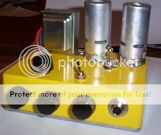

SO how small you want to go is this small enough. not much gain but its got some drive to it.
this ones the size of two packs of smokes with the older model powersupply but it will run two 4*12 marshall cabs loud enough to get the cops called on you in the middle of the day. Well at least that was the experience at mothers music
This last one was a prototype we later converted to run a single 6v6 at 400+ nice and crunchy

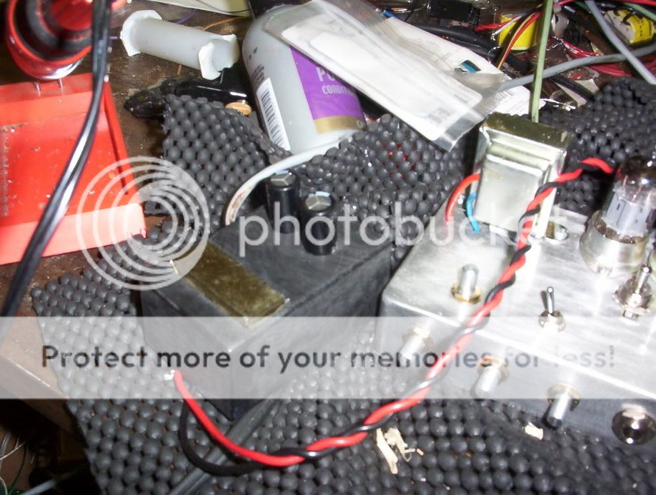

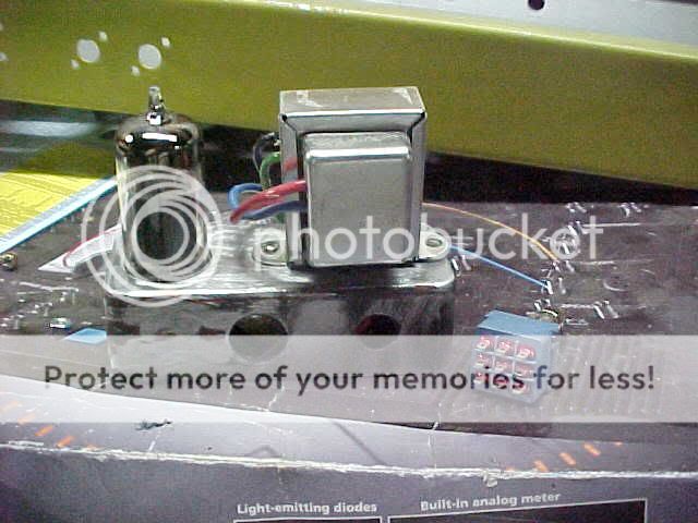

ok there is no edit button on my screen on some posts so heres some more

yes the output is in the back along with the powersupply connection. i found if you put your transformers in a case and rectify the dc on the hv and lv side you can use a stock ac adaptor with the middle lug as ground the hot lug as hv and neutral as you lv.
thats what i was doing with the small amps back in the day. i am still wanting to see someone do a full size medium to high gain amp with full size parts smaller than mine.

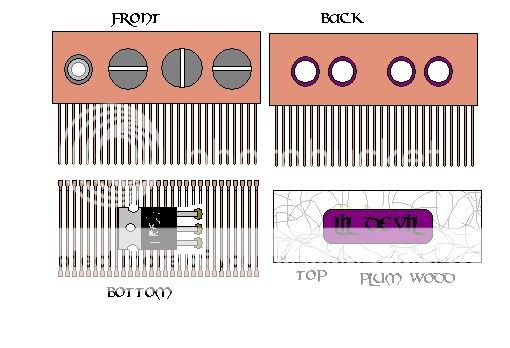

ah good idea. actually my amp up top is smaller than the one you build. check dimensions it only a little over an inch wide
my transformer is a standard fender champ
drawing of the lil devil
