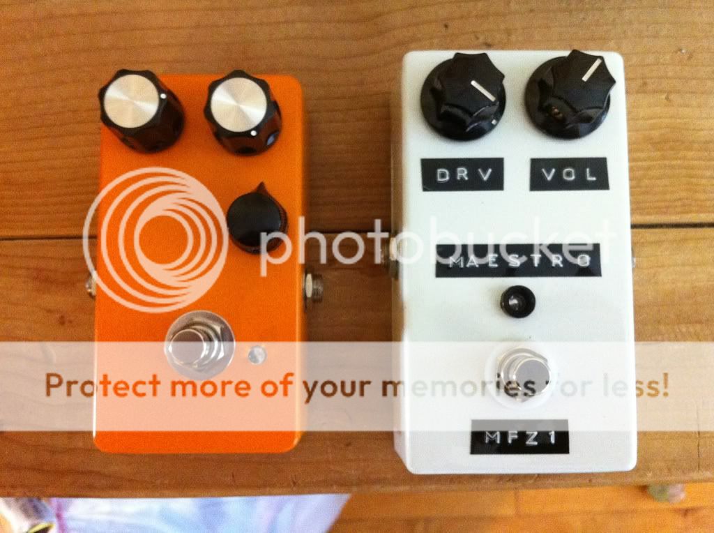

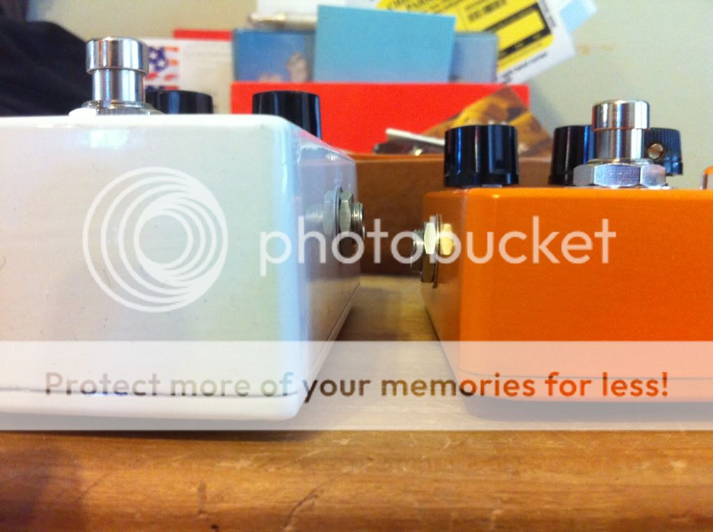

This is without a doubt, the most badass fuzz I've built. Period. I had a 16mm B50K pot laying around so I used that instead of the 47K resistor, for bias, and it works perfectly. I drilled and mounted it on the enclosure. Which, by the way, is a Zvex size enclosure from SmallBear. Tiny little bugger. http://www.smallbearelec.com/Detail.bok?no=960
They are listed as size B but I have a size B and this one is even smaller. Tight fit inside. That's why I used the smallest layout I could find (vero 11x11). But you know, with 3 big ass germanium transistors on the board, plus two 24mm pots and one 16mm pot... I'm a little bit proud that I was able to fit it all in there. It's a tiny pedal that packs a HUGE punch. The bias knob is super usable too. And it worked out so that the proper bias range is when the knob is set somewhere between 11 o'clock and 1 o'clock. It's nice to be able to fine tune the bias without opening up the enclosure.
THANK YOU to phibes and all of you guys! Seriously. Biasing via Q2's 47k resistor is definitely a better way to do it and I never would've known. :thumbsup
Here's a couple pics to show what I mean about the size difference. So glad I got it all to fit in there (that's what SHE said)

Glad you got it! Nice looking box too! Sometimes it's really easy to fuck up wiring the trimmers right.
Yeah the Q2 trimmer is definitely the way to go. I know Dave Main was the first to start implementing that as I didn't see it in any boxes before his, he knows Tone Benders so credit definitely goes his way. Really though, I don't know if I mentioned it in the other thread but there's a pattern that always got over looked. Go to Fuzzcentral for example (yes I know there not all 100 percent right) but if you look at the MKII's, Vox Tone Bender and Fuzz Face, you'll see that the 8K2 never changes but the other collector resistor varies from 10K-100K. Dave's hinted at that before. They we're obviously changing those for a reason.
