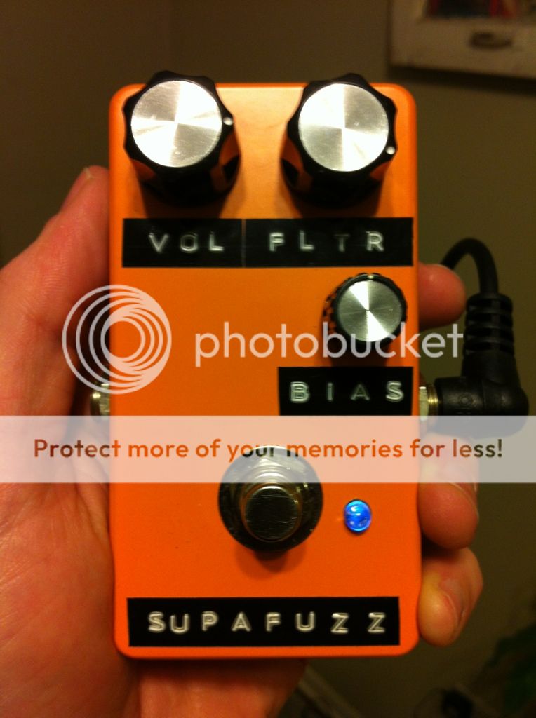

What I've got now is the GGG schematic posted above, except for I've changed the 2nd 4u7 cap to 10uF and added an external pot for bias.
*Question- I have one small issue and it's been happening since I first built this as a Supa... when I stomp the switch there is a slight delay before the fuzz comes out. I've never had that with any of my builds before. What did I do wrong? I'm not using a pulldown resistor or anything - should I be?

A lot of the old Tone Bender schematics are wrong, but close enough. It's hard to really pin point a go to schemo as the variants were so minor. There just wasn't the info back then as there is now.
No there shouldn't be a delay, how did you wire your switch?

Switch is wired like so-
http://www.generalguitargadgets.com/pdf ... gi_bat.pdf

So it turns out the issue was likely because I used a negative ground PNP layout. So it was decided that I should reverse the 3 electrolytic caps and then switch it to positive ground. I did so and now it has extremely low output. No fuzz, just very very low clean output. almost can't hear anything at all even with volume and fuzz knobs cranked full blast.
Do I need to switch the collector and emitter legs of the transistors around too? Please advise. I don't want to ruin them.

I don't know exactly what you did to make a pnp negative ground before, but now you are just wiring exactly the same as the schematic you referred to earlier.JVanDe7 wrote:So it turns out the issue was likely because I used a negative ground PNP layout. So it was decided that I should reverse the 3 electrolytic caps and then switch it to positive ground. I did so and now it has extremely low output. No fuzz, just very very low clean output. almost can't hear anything at all even with volume and fuzz knobs cranked full blast.
2 of the elctro +'s go to ground and 1 to the input. Q1/2 emitter go to ground and Q3 emitter to 100k/1K attack
if you changed from npn to pnp or vice-versa, the electros would flip, the battery would flip and nothing else

Alright. All I did was flip the electrolytics and the red/black from battery (and the LED/resistor). I touched nothing else. Not sure what the issue is here but I guess I'll have to fiddle with it for a bit and try to figure that out. Maybe I overheated a cap? Worst case, I'll just build it again with a different layout.

Did you double check everything to the schematic? Flipping stuff leaves for a good margin of error. That vero layout is a mindfuck to look at. Print that schematic out, and go over it with a highlighter making sure you got everything orientated right.

Yeah that layout is a mess. I thought it would be great since it's so small, and it does get a few points for that, but aside from that, the layout should be scrapped. The fuzz and volume are shown wired backwards, the negative ground causes problems with PNP transistors (seemingly), and it's not easy to work with since everything is right on top of each other. Sorry I don't mean to bitch so much, especially since I'm not even skilled enough to produce a layout myself, but I really screwed up when I decided to use that thing.
I've already decided to just do it right and redo the whole thing using this layout instead... (probably won't get around to it until the weekend but we'll see, having too much fun playing with my V846 wah I built last night)

Be careful. Your -9V wire should be black and the +veGround should be red and make sure you follow the POSITVE ground wiring layout from GGG.

The new board solved it. So now I'm back to a Sola Sound MKII and not a Supa Fuzz at all. Sorry for posting it in this thread but I wanted to tell the conclusion to my Supa Fuzz adventure/build. I used all the stock values shown on this layout...
http://tagboardeffects.blogspot.com/201 ... ional.html
The only mod I did is use a 50K external pot instead of the 100k resistor on Q2c (bias control). Sounds great! Not a Supa Fuzz though.

Not the Marshall made variant. That layout is based on an OCC81D Tone Bender MKII/Marshall Supa Fuzz. See page 3 of this thread for details.JVanDe7 wrote:Not a Supa Fuzz though.
