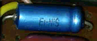

p.s
Whos this cap by?
Electric Warrior

EI Niš :mrgreen:

Oh Elektronska industrija Niš :mrgreen:
