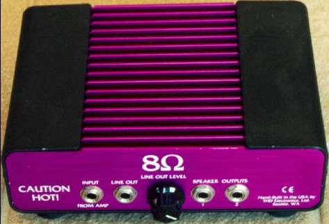

So if you were using an amp with no effects loop, and you wanted to use the amp's gain, what options would I have to run time based effects after the amp's gain (besides a mod)?
Could the THD Hotplate do this? Running the effects in it's Line Out.

There's a few different options you have with delays. Pretty much all delays today have a dry output. One thing you can do is send the dry output to your Mig 50 and send the wet output to a satellite amp. The satellite can probably be smaller and lower wattage, and clean or dirty, depending on the overall effect you want. It does require a separate amp, but it is one way of getting a clean delay without requiring mods.
And if you don't have a dry output on your time-based box, you can use an A/B splitter instead and put the pedal on the side going to the satellite amp.
Using a line-out from a load box is another idea, again that will require another amp to amplify the effected signal.
