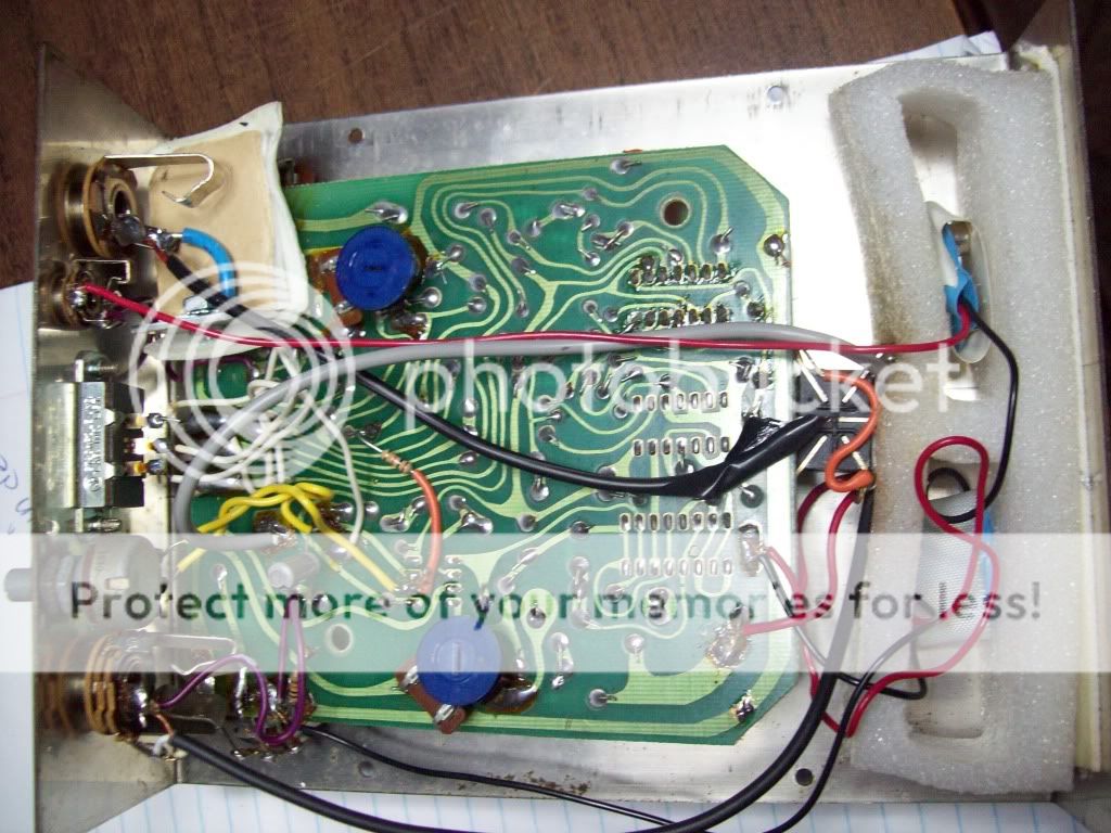

I bought this new in the late 70s. The board was removed in early 80s and installed from memory recently. I'm not able to find anyone who has this version. The board says EH 5200-1C NP. Does anyone have this version who could provide pics of the board connections.

The schem doesn't help? The copper side transistor seems odd, I haven't seen EH effects with such components upside down...

here is mine, looks like it is the same version as yours.

I have worked on a later (non-curved traces) model, but still the same circuit (just some extra filter caps)
I used the schematic for the EM18v that can be found on the net to follow the circuit without any problem.

I've an EH 5200-1A (blue label version) with curved tracks, and my circuit matches exactly this schematic. Hope this helps

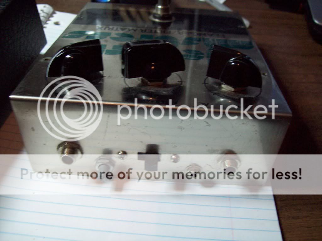

On mine there was a loss of volume in effect mode. So i added an volume pot (as seen on the pics)
I also added true byepass.
This pedal has lots of depht but lots of noise also. I have A/B with a new DLX electric mistress and found the new ones to be less noisier but less depht in the effect.

Would you share your volume knob mod? I have the same unit!
