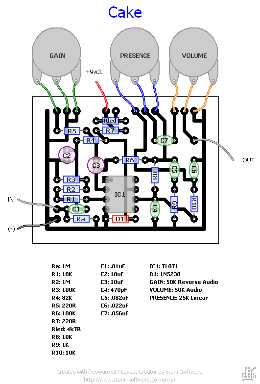

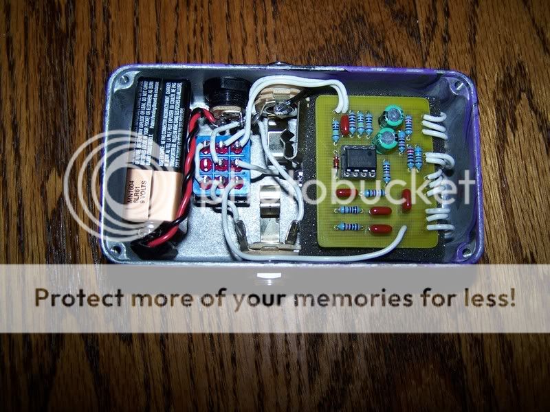

Built this today...
...from this layout I did some time ago...
Sounds very good....except, there is a very subtle gatey sound to the decay. This only happens in a small part of the gain pot rotation - just above halfway. If you turn the gain up or down it goes away. Tried an OPA134 and, if anything, it was worse. Double checked the layout and parts values in the pedal and all seems good.
Is this normal? Maybe some fresh eyes will see something I'm missing. :oops:
Try not to be a dick when speaking about others; try not to be pussy when others are speaking of you.
sounds like a parasitic oscillation problem - try placing a 22pf capacitor in parallel with the 100k feedback resistor - that should shut it up!!!

Thanks for the suggestion. Tried this tonight with no noticable change. Overall it sounds very good - it just has what I would call an "ugly" decay. I noticed tonight that this really happens all thru the range of the gain pot, it's just easier to notice at certain settings. At the very end of the note decay, it gets slightly splatty or gated sounding - this is very subtle - but it's definately NOT a smooth decay.
It also seems VERY compressed - not sure if this is normal or not.
IC voltages - Battery = 9.22v
pin 2 = 4.75v
pin 3 = 4.34v
pin 6 = 4.75v
pin 7 = 8.7v
