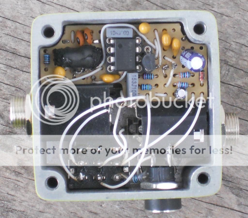

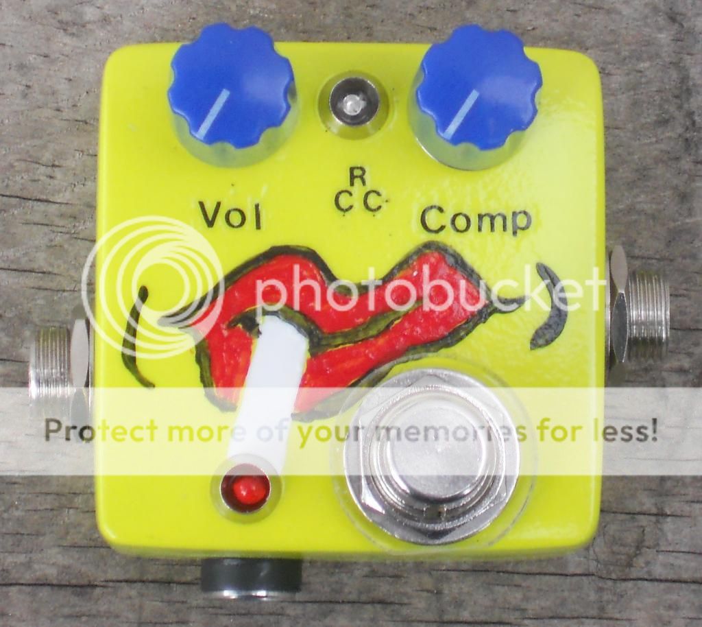

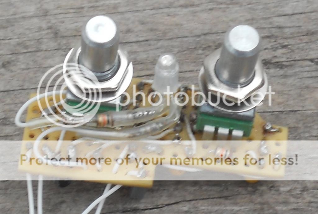

Hi guys,
just built it, so I took a couple of shots, here it goes:
Picture 1: see how i try to stop any external light source from hitting the ldr? just made a small box using some cardboard, and glue it to the pcb.
Picture 2: this is how far I got the LDR from the leds. I guess this is about the right space, the compressor really kicks!
Picture 3: overall gutshot
Picture 4: I did it on a 1590G enclosure. here's a pic comparing sizes with the 1590B (ep booster).
Now, I read in this topic some doubts about the leds didn't light up when testing the circuit. So I recorded this small video and show you how it should lit.
I am on my living room, only the TV is on. Also, the bright blue led is on. With the compress knob fully CW (100%), when I hit the tip of the cable with my finger, feeding the circuit with a signal (noise), this is what you should expect:
Hope this video helps.
