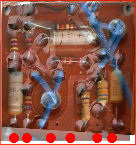

WEM, Watkins, Rush - Pepbox, Rush Pep Box [schematic]
This vero is unverified. I put it together using ElectricWarrior's schematic on page 2, and phibes' schematic of the Studio Two on page 3. Top-to-bottom the pinout of the transistors is CBE. It is designed for use with Alpha 9mm pots, but could just as easily be used for with regular pot wiring. If anyone notices any problems/mistakes, please let me know!
- Attachments
- pepbox_v1.png (13.18 KiB) Viewed 5304 times

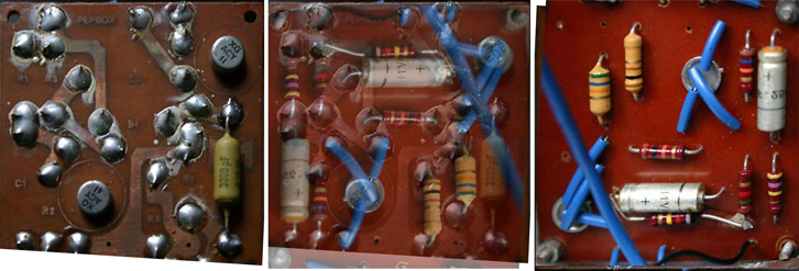

Musicground gave me the cap values of the GE version WEM fuzz. It's 25uf 25V. They could not read the pot values. However It think it just a matter of tuning the bias/gain pot to the transistors. Anything from 20k-100k depending on leakage.

Thanks a lot, here's the updated schematic:
- Steven_M
I'm a little confused about that 56k resistor before the volume control. Is that part lowering the volume of the circuit or is it affecting the tone as part of high/low pass filter? (I can never remember which is which)Electric Warrior wrote:Thanks a lot, here's the updated schematic:
- RnFR
it's going to do both. it's a HPF combined with the output cap, but having that resistor to ground is also going to affect the output volume. you would usually just combine the output cap and the volume pot as a HPF, so it is probably there to knock the volume down. they didn't like loud effects back in the day.

Wow - thanks guys! I feel ridiculously like it's xmas in March, as I only just saw the Music Ground guts pics yesterday, on their ridiculous £2K Pep Box auction - so much fun to have a 'new' circuit to build - and I do love ye olde 60s fuzz. I don't have much time at the moment, but will be on it soon.
