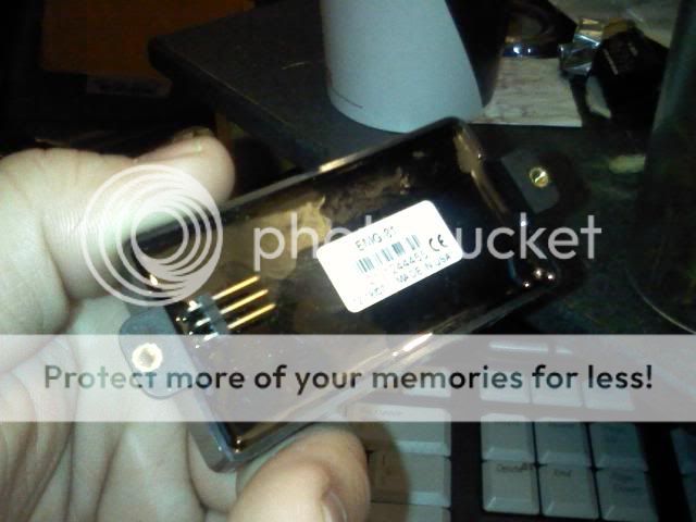

funny i thought i would ask emg if i could purchase two of their coils. since i have a bricked 81 at the shop. told them would be happy to purchase them the gent on the other side of the email said unfortunately they don't' sell the parts to their pickups but he had one in his desk that i could have. well how nice.
:) seems like i find some nice honest people once in a while.

got my emg over the weekend
