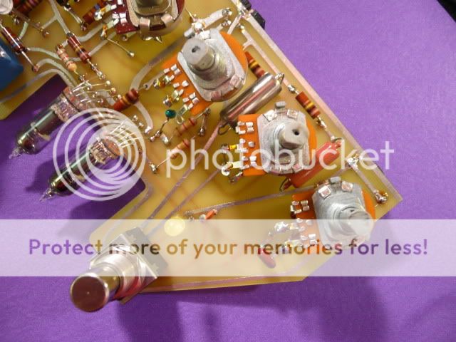

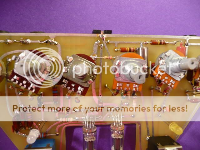

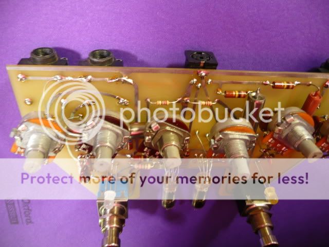

I need a new tube for this pedal and Siegmund won't tell me the replacement tube I need. Apparently that's a trade secret for him or something. As far as I'm concerned a replacement part like a tube should never be considered a trade secret. I would have never bought this pedal if i knew i would have to mail it in and pay $60 every time it needs a single tube replaced. If anyone can tell me the correct tube type that would be awesome.

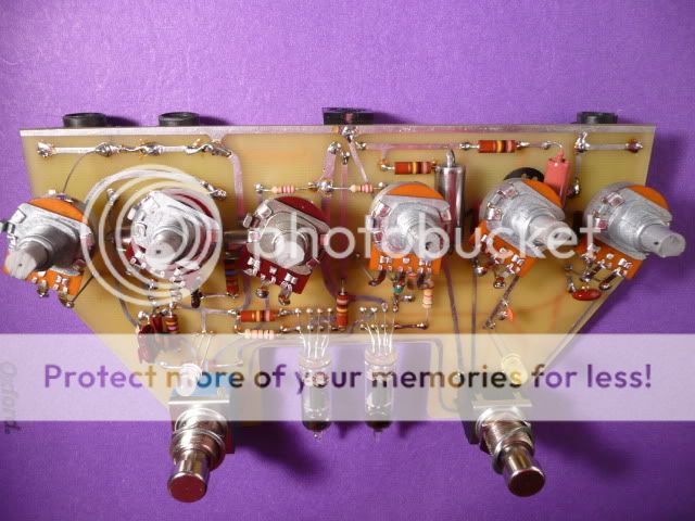

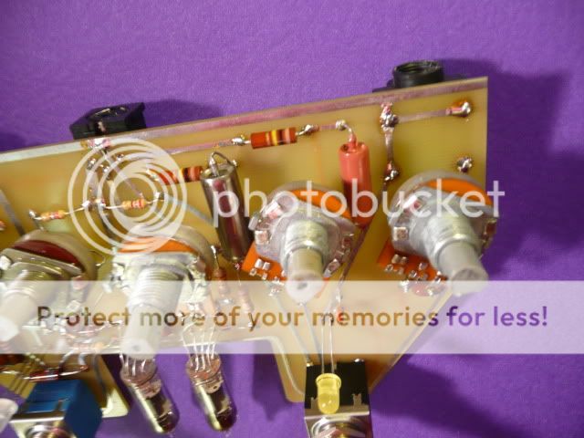

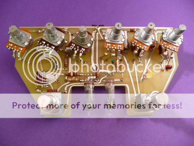

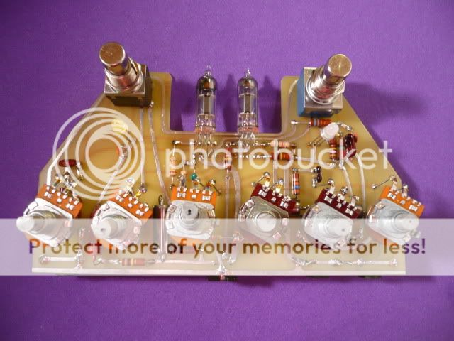

pot values left to right: 1 meg log, 220k log, 22k lin, 1meg log, 1meg log, 1meg log
caps: the two little ceramic caps on top are 100pf, the one on the right is in parallel w/ the resistor. The cap next to that is 47pf also parallel w/ a resistor. The cap near the second pot is a 27pf. the little green cap near the fourth pot just has a red dot on it (no idea) There is a 47pf cap under under both the 5th and 6th pots each in parallel w/ a resistor. There is a 47pf cap in front of the 6th pot. the ceramic cap on the bottom goes between 2 of the legs it's 220pf.
The three silver cylinders all look the same. I don't know what they are. caps? there is also a similar but smaller burnt orange cylinder near the 6th pot.

After looking these pics over i realized the pots are obscuring part of the circuit. I will take some shots of what's under the pots as well and post those soon. If anyone want's to request other pics or info, i will do my best to answer. My knowledge of electronics is probably a lot more limited than a lot of the members here. I have repaired my share of gear, but I have never built a single guitar pedal, or electronic circuit, so bear with me if i don't understand something.

staticinfinity wrote:pot values left to right: 1 meg log, 220k log, 22k lin, 1meg log, 1meg log, 1meg log
I made a mistake there. The little ceramic cap on the LEFT is an parallel with a resistor and the cap next to THAT is 47pf also parallel w/ a resistor. Hope that doesn't mess anyone up.

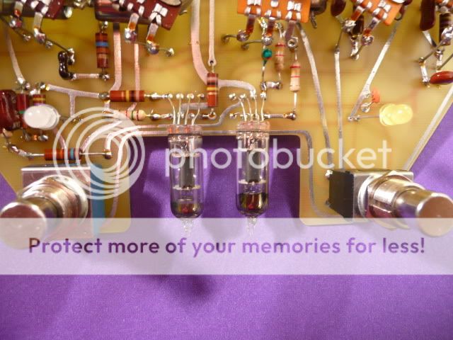

The tubes look to me very much like the unbranded 6111 that I buy from ebay seller w.e.s.1
If you wanna post up a traced schematic I could confirm this.

frequencycentral wrote:The tubes look to me very much like the unbranded 6111 that I buy from ebay seller w.e.s.1
They have to be some 6xxx and I also think 6111 is the most likely based on reading what the different 6xxx tubes are supposed to sound like. A couple people have said 6021w but siegmund told me it's not a 6021 (not that I would trust him). To my knowledge the only other tube it could be is 6112?

From the shots you've posted I see no voltage multiplier in the circuit. Therefore highly unlikely that it's a 6112, as these just don't work well at low voltage.
Also looks to me as there is a plate resistor at pins 1 and 8, so that would suggest 6### as opposed to a couple of pentodes.
If i was planning to market a low voltage submini dual triode based pedal (which I am), I'd use 6111, as they are plentiful and cheap. Do an ebay search, the 6111's you'll find from the guy I mentioned are unbranded and look identical.
No offence, but Seigmund seems a bit of a jerk to me.

I don't think i'm qualified to draw a schematic. I will try to put up enough pics so that someone more knowledgeable can draw one.

Anyway, you probably don't need the entire schematic drawn to figure out what tube type is in there. The plate resistors might tell the story. 6111 and 6021 types have a much lower plate resistance than the 6112. Who knows if the builder followed typical practices, but that is where to start looking. I'll look at the pictures and try to figure out what resistors are on pins 1 and 8.

Could be helpful to know the voltage of the power supply as well as the voltage at each tube pin.
