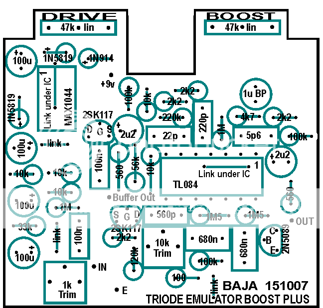

Hi friends
This design is an attempt to simulate the harmonic distortion characteristics of a triode valve (vacuum tube) using an n channel jfet in an unusual configuration. The design is based on an idea by Dimitri Danyuk, who presented it at an Audio Engineering society meeting in Berlin 2004. His emulator ran off a bipolar 15 volt supply and included a blend control to allow folks present to hear the difference between the emulator and a bypassed musical signal. he also included a peak detector to show the onset of distortion etc.
My version is adapted to fit in a Hammond 1590B case and runs from a 9 volt battery, although it does have a fairly high current drain, that could possibly be reduced by using a TL064 quad op amp instead of the specified TL084 used in my design. The design uses an MAX1044 charge pump to allow the fet to properly bias.
There are two trim pots - one adjusts the fet bias to achieve the triode type harmonic distortion law, the other adjusts the gain of the op amp for unity gain through the jfet stage.
If anyone is interested in Dimitri Danyuk's AES paper, please PM me with your email address and I will be only to happy to send you a copy for your info.
In closing, this is not your average overdrive or distortion pedal - it is not a tubescreamer or fuzz face etc, so do not expect endless smooth sustain from it, but if you build it, I am sure you will find it a very useful and unique sounding pedal, and there are many different distortion characteristics lurking in thesetting of the jfet bias trim pot, not necessarily triode sounding but definately interesting tweaking here.
I have been using this, my second revision of this design ( the original ran off 9v and is still in use by a local guitarist who looooves the way it drives his Fender Hot Rod Deville - he does not use the amps drive channel, he prefers the TE boost) for the last month and I like it so much, it hardly gets bypassed - the other guys in the band seem to like it too, because they have not told me to "turn that thing off" :lol: :wink:
anyway - here are the schems, layouts etc.

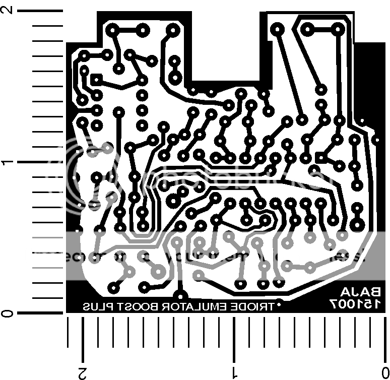

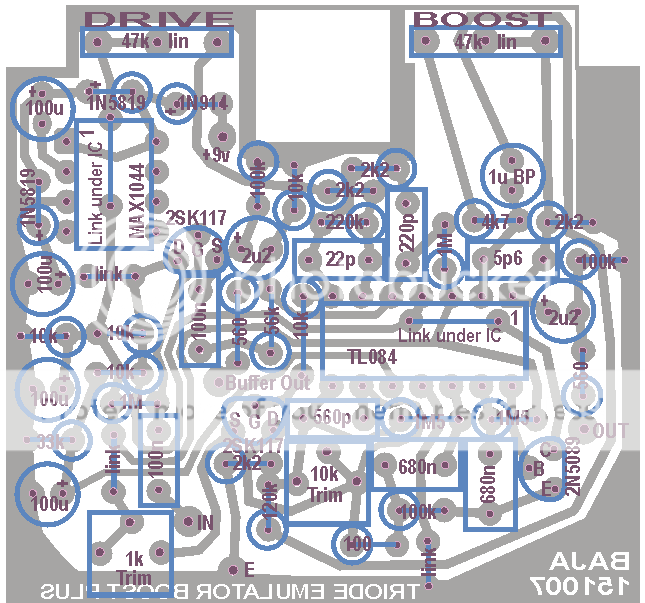

hint: I print and cut out the overlay and glue it to the component side of the PCB board (after drilling the holes) then I use a sharp point (pencil compass etc.) and poke through the paper overlay - makes component placement a no brainer :wink:
enjoy

DougH wrote:You'll have to explain what the op amp in the feedback loop does, when you get a chance.
Yeah, some explanation to trigger out a discussion would be pretty nice... :D
Sari
Posts: 45
Joined: 14 Oct 2007, 07:10
Has thanked: 26 times
Post by Sari »
Servo?
bacaruda
Posts: 68
Joined: 24 Aug 2007, 23:03
Location: USA
Post by bacaruda »
From the original AES paper (thanks Steve):
(IC3 is opamp in feedback loop of IC2)
"Operational amplifiers IC2 and IC3 form a highly linear current-to-voltage converter (Fig.6), which acts as a load to the FET stage and sets the gain. As the drain voltage of the FET is held at a constant level, the non1inearities associated with FET output network and gate-to-drain capacitance vanish. JFET has enough voltage across it to operate in the saturation region, while not that much to generate excessive noise due to reverse gate current. IC3 is used as a noninverting integrator in a servo feedback loop to ensure that the dc voltage at the output of the current-to-voltage converter remains close to the desired zero level. The IC3 stage works also as current source referring to the inverting input of IC2."

I just modify little pcb:
http://www.picvalley.net/u/67/16634_195.PNG
I remove a little gnd to prevent antenna effect.
there is nothing changed.
I have not had any problems, but that is cool by me.

Is that scale on the side of the PCB inches? Any tips on how to print it properly (I'm having problems printing 'em)?
