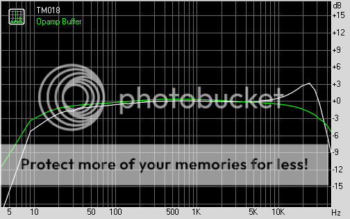

The LTZH can be used with passive signals without any signal loss. I don´t know the prize exactly, 55 - 60€, I guess.
If you have a buffered signal anyway, it´s definitely overkill.

I did some testing when i was building a buffer/splitter for my pedalboard using TM018 trafos.
Here's a frequency response of an TM018 driven directly from OPA4227 voltage follower against direct opamp buffer output:
As you can see it rings at about 24kHz, but it is well beyond typical "guitar" bandwidth.
The tests were made using 24bit 96kHz external card, the output of the buffer was going into 1Mohm input impendance.
