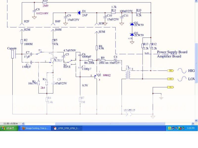

i have a motorola
30J7F 0503 its marked as a fet with D S G however all attemps to find a datasheet or even a suitable replacement have failed.
its a groove tube st-55 mic
mictester

ansil wrote:i have a motorola
Could it be a J307? That's a VHF P-channel FET.

got a link to datasheet. it could very well be that i coudlnt' find anything on it.
i guess i should mention that it is a to-92 case

ansil wrote:got a link to datasheet. it could very well be that i coudlnt' find anything on it.
The J307 comes in a TO92 case (not much help, really, as a large percentage of transistors come in those!).
Why do you need to replace the device?

it died on me.

Post by ansil »
ok the j307 looks like suitable replacement for it. but no luck on finding it to-92 case. and i forgot to add that the previous one was in a metal can. i did however find the preamp schematic for it courtesy of lovely chaps at fender.
